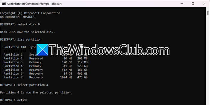

5] Mark Windows Partition as Active
If you have installed both operating systems on a single disk, we suspect that you have unintentionally disabled the Windows partition as inactive. To mark it back to active, we need you to follow the steps mentioned below.
- Boot into your PC using the installation media
- Now, go to Repair your computer > Troubleshoot > Advanced Options > Command Prompt.
- We are going to trigger the diskpart utility, for that, run
diskpartand hit Enter. - Execute –
select disk 0. - Run
list partitionto list out all partitions, we need to select the partition where Windows is installed. - For that, run
select partition <partition-number>. - Then, type
activeand hit Enter.
Finally, reboot your computer.
