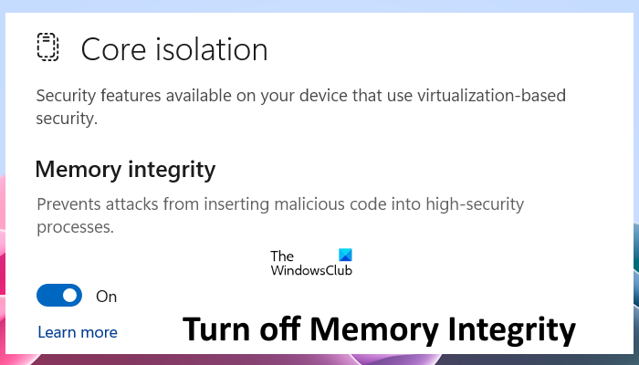

1] Turn off Memory Integrity via Windows Settings
Use the following instructions to turn off Memory Itehgrity on your system through the system settings.
- Go to Settings > Update and Security > Windows Security. Click to launch it.
- Click on the hamburger menu on the top left and then click on Device Security.
- Under Core isolation, select Core isolation details.
- Toggle off Memory integrity.
- You’ll need to restart your computer for the changes to take effect.

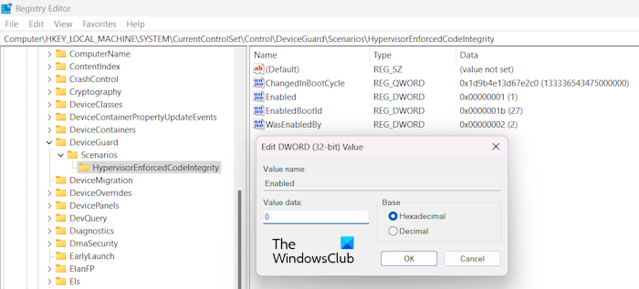

2] Turn off Memory Integrity through the Registry Editor
You can also use Windows Registry Editor to disable the memory Integrity. This method requires modifications in Registry Editor. Therefore, before you proceed, we recommend you create a System Restore Point and back up your Registry.
Open the Registry Editor and navigate to the following path:
HKEY_LOCAL_MACHINE\SYSTEM\CurrentControlSet\Control\DeviceGuard\Scenarios\HypervisorEnforcedCodeIntegrity
The easiest way is to copy the above path and paste it into the address bar of the Registry Editor. After that, hit Enter.
Make sure that the HypervisorEnforcedCodeIntegrity key is selected on the left side. Now, double-click on the Enabled value on the right side and enter 0 in its Value data. Click OK to save the changes.
Restart your computer for the changes to take effect.
The memory Integrity will be turned off on your system.
