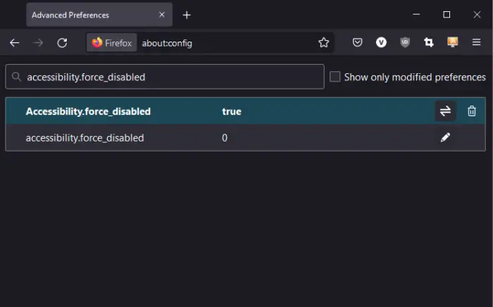

3] Look for accessibility.force_disabled
You will now want to find the correct section, which means you must use the search area via the Config menu to locate accessibility.force_disabled. After you’ve completed your search, it should appear in the results area.
4] Disable accessibility.force_disabled
To disable this feature, please click on the plus icon at the right. If it is set to true, then that means the feature is enabled. Simply double click to change it to false, which would then suggest the feature is now disabled.
If you see the value as 0 then you need to change the value of accessibility.force_disabled from 0 to 1 to disable the Accessibility Service.
Now if you open about:support, you will see that Accessibility features in Firefox have been disabled.
