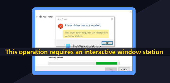

In this post, we will help you solve This operation requires an interactive windows station error on Windows 11/10. This error message occurs when users try to install or add a printer (local printer or network printer) or install print drivers. When they try to do so, the following error message appears:
Printer driver was not installed.
This operation requires an interactive window station.
What is an interactive Windows station?
An interactive window station contains a mouse, keyboard, and display device, and is named WinSta0. It is the only window station for receiving user input or displaying a user interface. Whenever a login session is started for a user using Remote Desktop Services, that session is associated with its own interactive window station. Sometimes, users may encounter error messages related to the interactive window station like the one mentioned above.
The main cause of this error message is the users don’t have administrative privileges to the required driver folders. The printer driver doesn’t work, the printer installation is interrupted or failed and this error message is displayed. A Group Policy or Registry entry configured to limit print driver installation to Administrators could also be the reason for it. Thankfully, some helpful solutions are there to fix this problem. You should create a restore point before proceeding further.

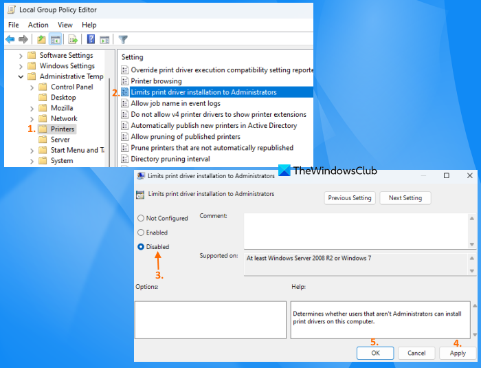

4] Configure Group Policy Setting
Check if a Group Policy setting is configured that restricts print driver installation to Administrators only. By default, users that aren’t Administrators can’t install the print drivers. But you can change this setting. For this, use the following steps:
- Type gpedit.msc in the Search box
- Press Enter key to open the Group Policy Editor window
- Jump to the Printers folder using the path given below:
Computer Configuration > Administrative Templates > Printers
- Double-click on the Limits print driver installation to Administrators setting available on the right section to configure it
- A new window will open. Now, change the setting from Enabled/Not Configured to Disabled so that the system will not be limited to installing print drivers to your computer by Administrators only
- Press the Apply button
- Press the OK button.
You might need to restart your system. Now try to install the print drivers or add your printer and you shouldn’t face that problem again.

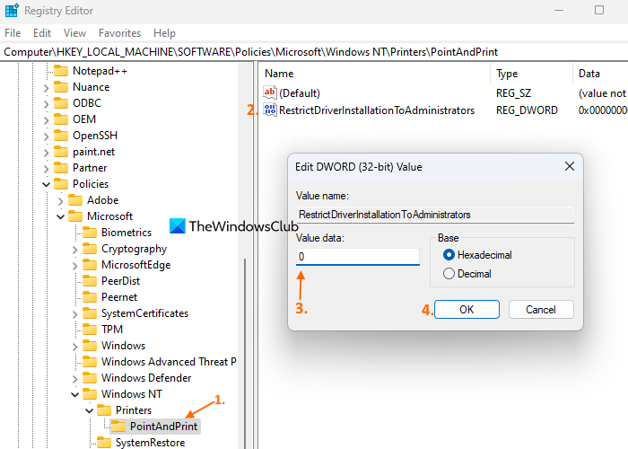

5] Set RestrictDriverInstallationToAdministrators using Registry Editor
An equivalent Registry entry named RestrictDriverInstallationToAdministrators for the same Group Policy setting is also available that you can configure to allow non-admins to install unsigned and signed drivers to a print server and update drivers. Here are the steps:
- Type regedit in the Search box
- Hit the Enter key
- In the Registry Editor window, access the PointAndPrint Registry key. The path is:
HKEY_LOCAL_MACHINE\SOFTWARE\Policies\Microsoft\Windows NT\Printers\PointAndPrint
- Double-click on the RestrictDriverInstallationToAdministrators DWORD value to edit it. A small box will pop up
- Put 0 in the Value data field of that box
