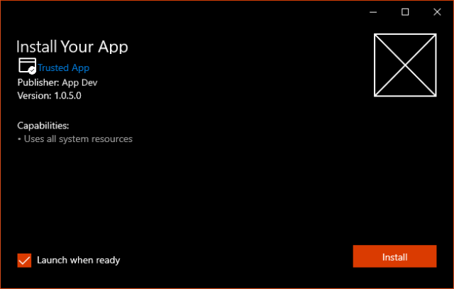

If the error message This app package is not supported for installation by app installer is troubling you, then this post may help you. The App Installer is a Windows OS utility that installs and maintains applications packaged in .appx or .appxbundle installation packages. Using this utility, users don’t need PowerShell and other developer tools to deploy apps on their PC. However, the app installer can sometimes face difficulties installing certain app packages. If that happens, this error message will appear.
This app package is not supported for installation by App Installer because it uses certain restricted capabilities.
Fortunately, you can follow some simple suggestions to fix it.

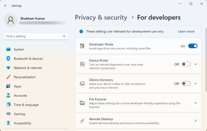

1] Enable Developer Mode
Developer Mode should be enabled on your device for installing App packages. Without doing so, you may have difficulty sideloading the app. Enable Developer Mode and see if the error gets fixed. Here’s how:
- Navigate to Privacy & security > For developers.
- Turn on the toggle switch beside Developer Mode.

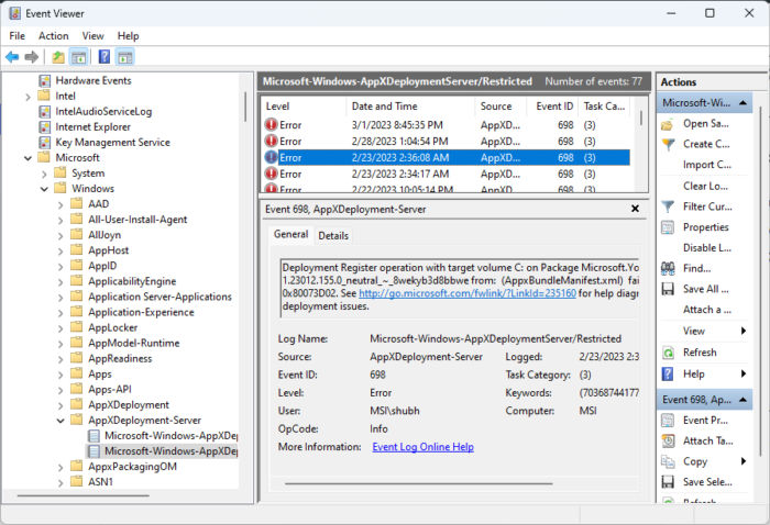

6] Check App Installer Event Log for Errors
If you still face the issue, check the app installers’ Event Log for errors. App deployment infrastructures emit logs data useful to debug installation errors. Here’s how you can check:
- Press on Start, search for Event Viewer and open it.
- Inside the Event Viewer navigate to the following path:
Application and Services Logs > Microsoft > Windows > AppxDeployment-Server
- Check all the errors one by one and see if one of them is causing installation issues.
