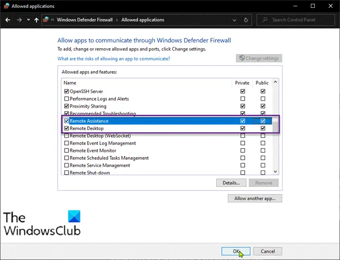

2] Enable Remote Desktop/Assistance in Firewall
To allow Remote Assistance in firewall on your computer, do the following:
- Press Windows key + R, type control in the dialog box and hit Enter.
- Once the control panel pops up, type Firewall in the search bar at the top-right side of the window and hit Enter.
- From the results, click on Allow an app through Windows Firewall which is a subcategory underneath Windows Firewall.
- Click on Change settings and make sure that entries enforcing RPC are checked such as Remote Assistance.
Restart your computer and see if the issue is resolved.

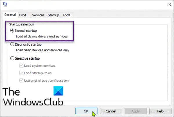

3] Change Startup Selection from Selective startup to Normal startup
The selective startup is a booting method which allows your computer to turn on with a minimal number of items loaded. This is usually done when troubleshooting issues with your computer which might involve other third-party applications. However, whenever you boot using selective startup, your computer will also not load all the RPC components onto your computer. In this case, we will select the normal startup and see if this fixes the issue. Here’s how:
- Press Windows key + R, type msconfig in the dialog box and hit Enter.
- Once in the startup configuration, select the tab General and choose the option Normal startup.
- Click Apply > OK to save changes and exit.
You will be prompted for a restart. Restart immediately using the popped-up window and check if the error message is resolved.

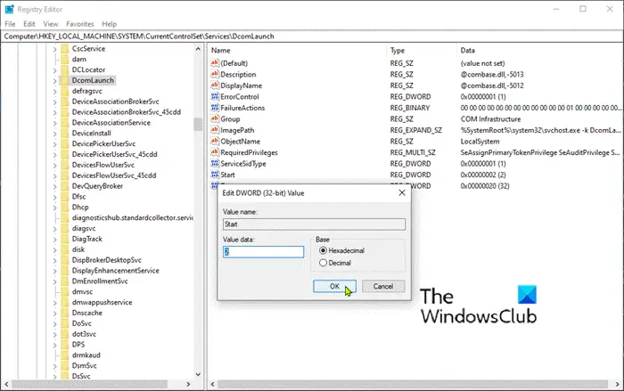

Next, use the left-hand pane or the navigation bar at the top (paste the registry path and hit Enter) to navigate to this location:
Computer\HKEY_LOCAL_MACHINE\SYSTEM\CurrentControlSet\Services\DcomLaunch
- Once you get to that location, double-click on Start from the right-hand pane.
- Then, set the Base to Hexadecimal and the value data to 2.
- Click OK in order to enable the DCOM Server Process Launcher.

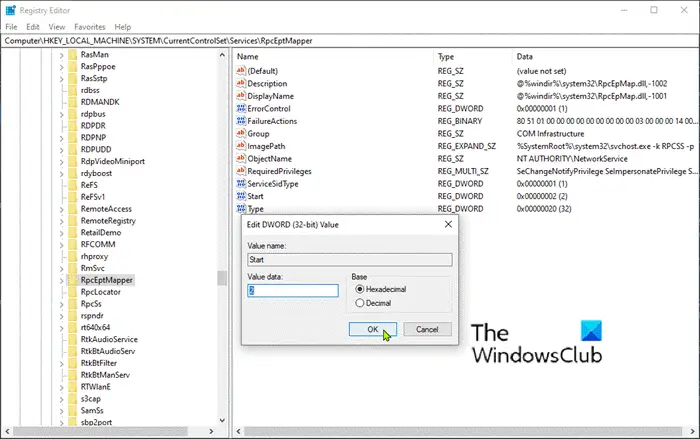

Lastly, navigate to the following location by using the navigation bar at the top or by using the left-hand pane:
Computer\HKEY_LOCAL_MACHINE\SYSTEM\CurrentControlSet\Services\RpcEptMapper
- Move over to the right-hand pane and double-click on Start.
- Then, set the Base to Hexadecimal and the Value Data to 2.
- Click OK.
Close the Registry Editor, restart your computer and see if the ‘The RPC server is unavailable’ issue has been resolved at the next system startup.
