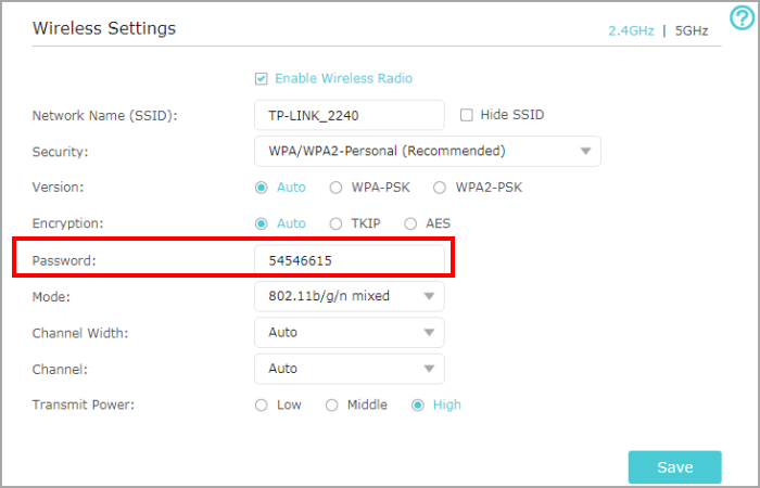

2] Generate a new password for your WiFi
The next thing you can do to fix the issue is to create a new password for your WiFi. And then, enter the newly created password to set up your WiFi on Windows 11/10. Here’s how you can do that:
Firstly, start a web browser and open your router settings. You can enter one of the following IP addresses to access the router settings page:
192.168.0.1 192.168.1.1
After that, you need to sign in with your username and password for your router to access its main settings. So, do that and navigate to the Wireless Security section.
Next, enter a new password in the respective field and then press the Save button to save changes.
Now, try entering the newly generated password as the security key for your WiFi and see if the “The network security key isn’t correct” error is resolved or not.
