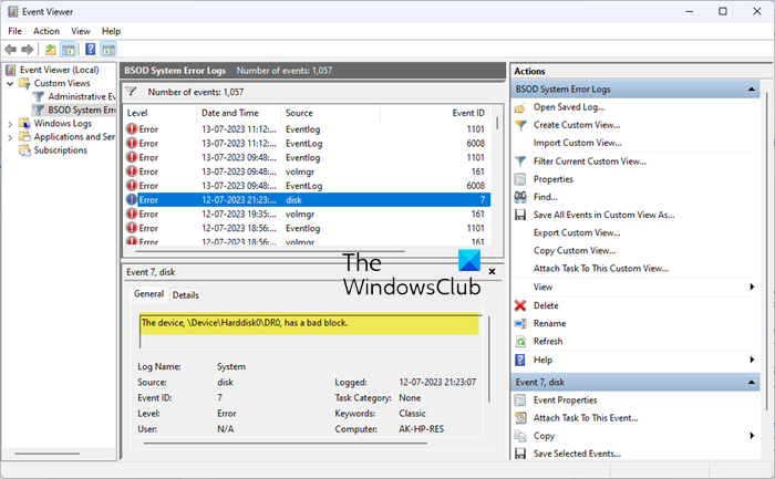

When faced with multiple errors, some users went to the Event Viewer and noticed that they have Event ID 7 with an error message that says The device, \Device\Harddisk0\DR0, has a bad block. Folks have also seen this error when their computer failes to boot with error message Default Boot Device Missing or Boot Failed. The error indicates there could be a Bad Block on your hard disk, as a result of which your system failed to work as expected, crashed or could not boot at all.

Fix The device, \Device\Harddisk0\DR0, has a bad block, Event ID 7
If you get The device, \Device\Harddisk0\DR0, has a bad block, Event ID 7 on your Windows computer, follow the solutions mentioned below.
