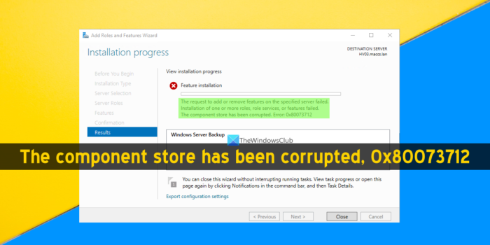

When trying to install a role or feature (like Windows Security Updates or Server Backup feature) to the Windows Server, the feature installation fails and some users get to see a message saying The component store has been corrupted, error 0x80073712. Instead of the Add Roles and Features Wizard completing successfully, this message pops up! We will talk about solutions that may help you resolve this isue. The entire error message for this Windows Server wizard looks like this-
The request to add or remove features on the specified server failed. Installation of one or more roles, role services, or features failed. The component store has been corrupted. Error: 0x80073712
The component store has been corrupted, 0x80073712
