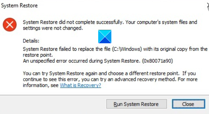

When trying to restore the system using System Restore, the program may fail to work and throw up the following error message – System Restore did not complete successfully. An unspecified error occurred 0x80071a90. If you face this issue, then this post may help you fix the issue.
System Restore failed to replace the file with its original copy from the restore point.
An unspecified error occurred during System Restore (0x80071a90)
Fix System Restore did not complete successfully, Error Code 0x80071a90

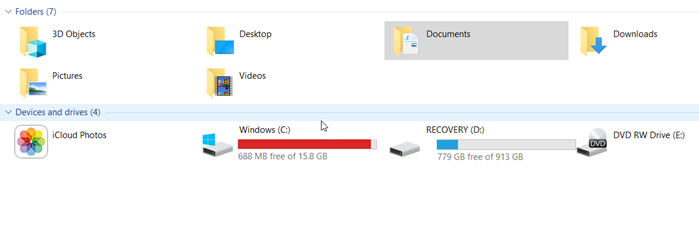

1] Check available Disk Space
You can’t just keep adding stuff to a drive and leave it that way. It should be checked for the free space available from time to time. The same principle applies when you have System Restore enabled. Check if you have sufficient Disk space available when you get the ‘System Restore did not complete successfully’ error message. If not, use Disk Cleanup Tool to clear out junk files. hen, proceed with the process.
