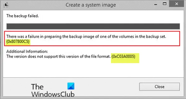

The advantage of a system image is that, if a hard drive crashes, you can replace it, restore the image, and have your system right back to where it was when the image was captured. No need to reinstall Windows or your apps. Some PC users when attempting to create a system image backup on their Windows 11/10 device, may encounter the error codes 0x807800C5 and 0xC03A0005. If you’re faced with a similar issue, you can try the solutions provided in this post to successfully resolve the issue.
There was a failure in preparing the backup image of one of the volumes in the backup set (0x807800C5)
When you encounter this issue, you’ll receive the following full error message;
Create a system image
The backup failed.
There was a failure in preparing the backup image of one of the volumes in the backup set. (0x807800C5)
Additional Information:
The version does not support this version of the file format. (0xC03A0005)
System Image Backup errors 0x807800C5 and 0xC03A0005
If you’re faced with any of these error codes, you can try our recommended solutions and see if any of them help you resolve the issue.
