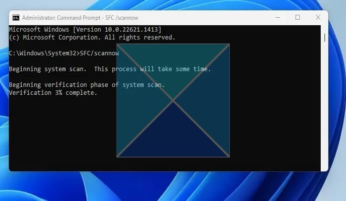

1] Run an SFC scan to repair corrupted system files
One of the primary causes of the “The system could not find the environment option that was entered” error is damaged or missing system files. So, if the scenario is applicable, you should be able to fix the error by running an SFC scan.
SFC stands for System File Checker. It is a command-based tool that lets you scan and repair corrupted system files. It comes with Windows. Here’s how you can run an SFC scan:
First, open the Command Prompt with admin rights. After that, enter the below command:
sfc /scannow
Once the command is finished, reboot your computer and check if the error is fixed.

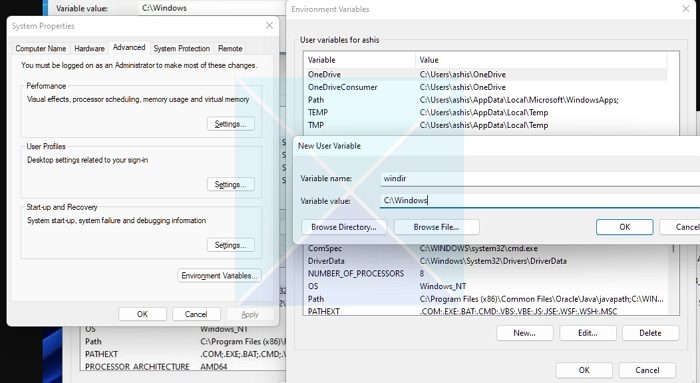

Method 1: Boot Windows in Safe Mode and use Advanced system settings
- First, boot your Windows computer in Safe Mode.
- Now, open Windows Search, type View advanced system settings in the search box, and click on the top result.
- After that, press the Environment Variables button in the Advanced tab.
- Next, under the System variables section, tap on the New button.
- Then, type windir in the Variable name box and enter C:Windows in the Variable value field.
- Finally, press the OK button to save changes and reboot your computer to check if the error is fixed.

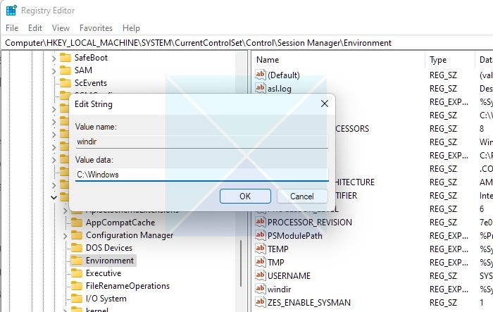

Method 2: Use Registry Editor
First, press Win+R to open Run and enter regedit in it to open Registry Editor. Now, navigate to the following location in the address bar:
Computer\HKEY_LOCAL_MACHINE\SYSTEM\CurrentControlSet\Control\Session Manager\Environment
Next, check in the right-side pane and see if there is windir string or not. If not, you need to create it. For that, right-click on it and choose the New > String Value option.
After that, enter windir as the value name of the created string and then double-click on the created key. In the Edit String dialog, type C:Windows in the Value data field and press the OK button to save changes.
Finally, close Registry Editor and reboot your computer to apply new changes. You should not face the same error anymore.
