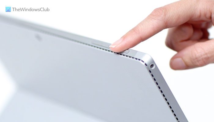

The process to restart your Surface may vary depending on the version. For example, if you use Surface Pro 5 or later, Surface Go, Surface Studio, or Surface Book 2 or later, you need to press and hold the Power button until it shuts down and restarts. For your information, it may take 20 seconds to start the restart process. You need to hold the button for that much time.
On the other hand, if you have Surface Pro 1, 2, 3, and 4 or Surface Book 1, Surface 2/3/RT, etc., you need to press and hold the Power button for almost 30 seconds. Then, press and hold the Volume Up and Power buttons together for 15 seconds.
Once done, your device will restart automatically.
