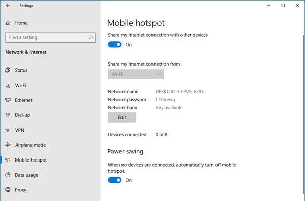

- Open Settings > Network & Internet
- Click on Mobile Hotspot
- Toggle on Share my Internet connection with other devices
- Against Power saving, toggle off the option – When no devices are connected, automatically turn off the mobile hotspot.
In Windows 10:
- At the end of the settings, toggle off the option – When no devices are connected, automatically turn off the mobile hotspot.
Post this; even if you do not have a device connected to Mobile Hotspot, it will remain always on. The option is visible only when you turn on Mobile Hotspot.
