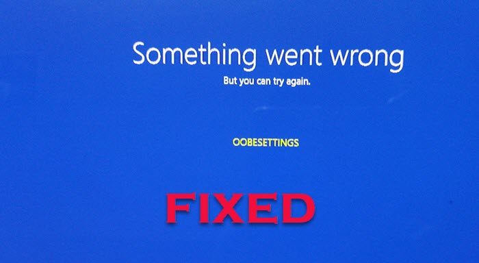

When setting up the Windows 11/10 computer, you might get Something went wrong – OOBESETTINGS message. In this post, we will see how you can resolve this issue.
When you encounter this issue. you’ll receive the following full error message;
But you can try again.
OOBESETTINGS
This issue occurs because the specific timing of the OOBE process causes a deadlock situation. This issue does not involve hardware, and you can easily fix it.
When you start a new Windows-based computer for the first time, the Windows Out-Of-Box Experience (OOBE) process guides you through various setup operations. In rare cases, you may encounter one of the following issues during OOBE.
So, if you’re faced with this OOBESETTINGS error, all you have to do is click on the Try again button at the bottom of the error screen. Usually, this corrects the error and the OOBE wizard can continue to complete the setup.
However, in the case where you receive the error again, you have to force a full shut of your system by pressing and holding the power button until the system turns off. When you power on the device again, Windows will simply restart and ask you to configure OOBE settings again as the Windows is already installed – it’s just the OOBE that hasn’t been completed yet.
