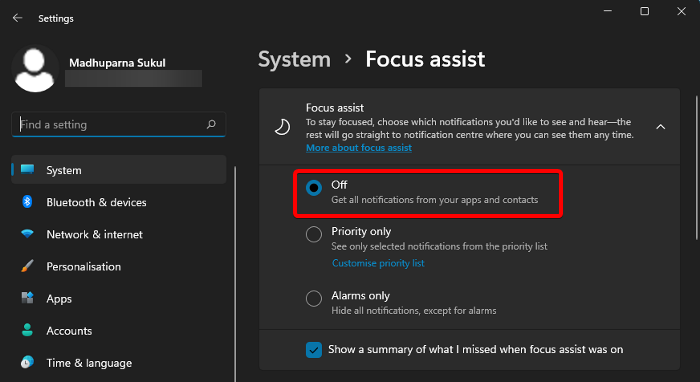

1] Disable Focus Sessions
One of the main reasons why the Slack notifications are not working is that you may have Focus Assist enabled on your system. While it helps you to stay distraction-free, it also hides notifications from all apps, including Slack. Hence, it’s recommended to disable Focus Assist to fix the issue.
For this, open Windows Settings (Win + I) > System > Notifications > Notifications from apps and other senders > Turn off Focus Assist to disable Focus Sessions.
Or, open Windows Settings (Win + I) > System > Focus Assist > select Off to turn off Focus Assist and continue to receive notifications. You can also select Priority only > select Customise priority list > Apps > Add an app > add Slack.
Once the issue is resolved successfully, you can enable the Focus Sessions feature again.

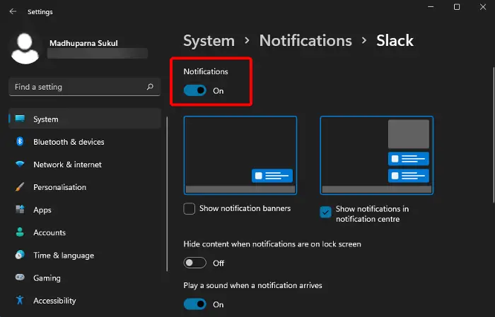

2] Allow Slack to send notifications
It could be possible that you have not yet enabled the notifications in Windows 11 Settings for the Slack app and hence, it’s not working. In this case, all you need to do is open Windows Settings ( Win + I), select System on the left, and click on Notifications on the right.
On the next screen, go to Notifications from apps and other senders, look for Slack, and turn it on. Now, you won’t miss any notifications from the app.

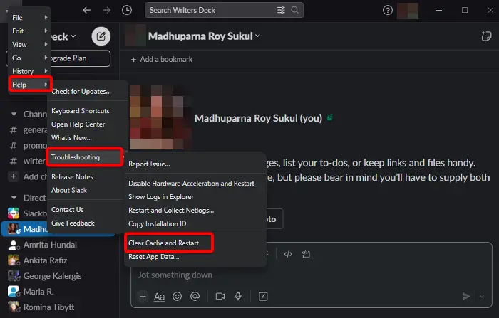

4] Delete cache data from Slack
If the cache data in Slack has gone corrupt, chances are, this is causing the notifications not working issue on your Windows 11 PC. To fix this, open Slack > hamburger menu (≡) > Help > Troubleshooting > Clear Cache and Restart. The cache data in Slack is now cleared and will restart automatically.

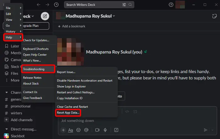

5] Reset app data for Slack
Sometimes, there could be an issue with your Slack profile, and hence, notifications are not showing. For this, it’s recommended to reset the app adat for Slack. For this, launch Slack, click on the three parallel lines (≡), and select Help. Next, select Troubleshooting and then click on Reset App Data.

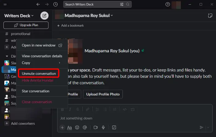

7] Unmute conversation
Are you sure you did not mute the conversation for a specific participant? It could be accidental as well. So, if you are not receiving notifications for a participant, open Slack, right-click on the said profile, and select Unmute Conversation.
