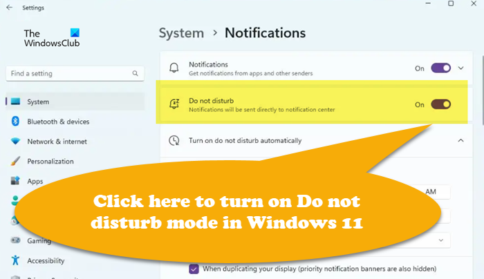

Enable Do Not Disturb Mode in Windows 11
If you do not want to be disrupted while focusing on a difficult task or simply do not want to see notifications pooping on your screen, you can enable Do not disturb on your computer by following the steps given below:
- Enter Win + I to open Settings.
- Select the System option and click on the Notifications tab.
- Switch on the toggle key next to the Do not disturb option.
This way you will not be disturbed by notification banners every few seconds, however, you can check them after completing your task from the Notification Center.
