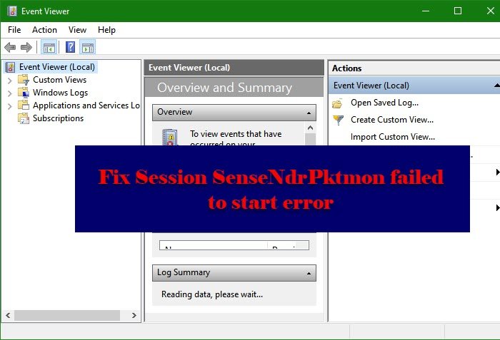

Some Windows users are reporting that their computer randomly locks up and they have to do to Hard Reset to get it back on track. When they did a bit of probing in the Event Manager, they saw “Session SenseNdrPktmon failed to start” message with error code 0xC0000035. In this article, we are going to see some ways to fix this error.
What is SenseNdrPktmon?
The error message SenseNdrPktmon failed to start with the following error 0xC0000035 is seen when folks open the Event Log on their Windows computer after experiencing issues such as the computer getting locked up or stuttering. SenseNdrPktmon is the Data/Session name. There are a lot of reasons that can cause the error and we will talk about them hereinafter.
