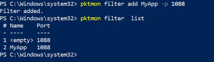

So coming back to our topic, let’s assume that we are going to monitor TCP port no 1088. It can be a port used by your custom application, which is crashing, and PktMon can help you figure out if the network is the problem.
Open Command Prompt or PowerShell with admin privileges
Create a packet filter using the command: “pktmon filter add -p [port]”
pktmon filter add -p 1088
You can then run the command “pktmon filter list” to see a list of added filters.
To remove all the filters run the command “pktmon filter remove”

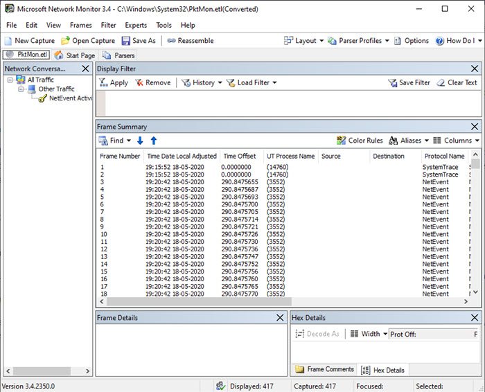

3. Export Log into a readable format
The log file is saved into PktMon.ETL file which can be converted into a human-readable format using the following command
pktmon format PktMon.etl -o port-monitor-1088.txt
Having done that, while you open the file in notepad, and read it, to make sense, you will have to use the Microsoft Network Monitor. It can directly read the ETL file.
