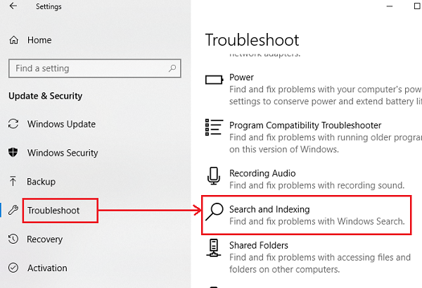

1] Run the Search and Indexing Troubleshooter
Click on the Start button and select Settings > Updates and Security > Troubleshoot. Select the Search and Indexing Troubleshooter from the list and run it.
Restart the system once done.

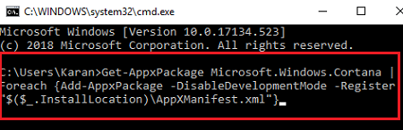

Right-click on the Start button and select Windows PowerShell (Admin).
Type the following command in the elevated PowerShell window and press Enter to execute it:
Get-AppxPackage Microsoft.Windows.Cortana | Foreach {Add-AppxPackage -DisableDevelopmentMode -Register "$($_.InstallLocation)\AppXManifest.xml"}
Restart the system.
