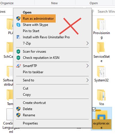

In this post, we will show you how to open or run File Explorer (explorer.exe) with elevated privileges or in administrator mode in Windows 11/10. Windows File Explorer or explorer.exe is also set to run in the standard user context. Even if you right-click on explorer.exe, and select “Run as Administrator”, it will still run in the standard user context. The problem is caused by the fact that User Account Control can only elevate an application to a higher token when it is launching a new process. It cannot elevate an existing process.

First, you need to terminate the existing explorer.exe process.
- Open Task Manager
- Locate explorer.exe process
- Right-click on it and select End Task.
Having done that you have three options to run explorer.exe run as admin..
