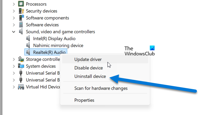

5] Uninstall the audio drivers and install the fresh ones
You may notice that the Realtek Audio Console is not detecting the headphones if the audio drivers are corrupted. To resolve the issue, we will uninstall the audio driver and then install a fresh copy of it. Follow the steps mentioned below to do this.
- Open Device Manager.
- Expand Sound, video, and game controllers.
- Then right-click on Realtek Audio driver, and click on Uninstall device.
- Click on Uninstall.
- After uninstalling the driver, right-click on Sound, video, and game controllers, and click on Scan for hardware change.
