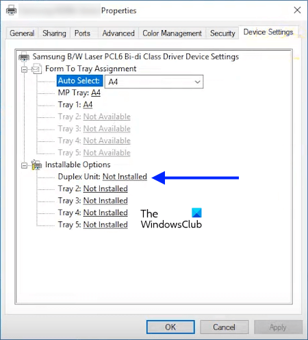

2] Check your Printer Properties
Some printers have a built-in Duplex unit, whereas, some have a separate Duplex Unit. This separate Duplex Unit needs to be installed on the printer if you want to print on both sides of a paper. After installing the Duplex Unit on the printer, you need to change a setting in the Windows computer, otherwise, Windows OS will consider that the Duplex Unit is not installed on the printer and you will not be able to print on both sides of the paper. The same thing also applies to printers with a built-in Duplex Unit.
Follow the steps provided below to check this setting in your Windows computer:
- Open Windows 11/10 Settings.
- Select Sevices > Printers & scanners on Windows 10. If you are a Windows 11 user, go to Bluetooth & devices > Printers & scanners.
- Select your printer and then click on the Printer properties.
- On the printer properties window, select the Device Settings tab.
- Under the Diuplex Options, Change the Duplex Unit option from Not Installed to Installed.
Now., check if the issue persists.

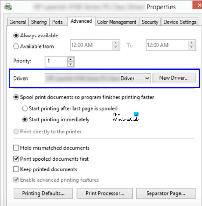

3] Select the right driver for your printer
Make sure that the right driver for your printer is selected on your Windows computer, otherwise, Duplex Printing will not work. To check this, follow the steps provided below:
- Open your printer properties.
- When the printer properties window appears, go to the Advanced tab.
- Select the right printer driver in the Driver drop-down.
