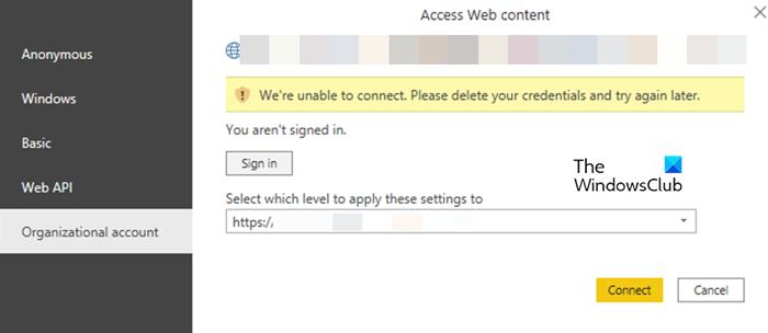

When trying to connect to data sources and authenticate using an authenticator such as oAuth, you may get an error in PowerBI that asks you to delete the login credentials. In this post, we will discuss this issue and see what can be done to resolve this problem.
We’re unable to connect. Please delete your credentials and try again later
Fix We’re unable to connect, Please delete your credentials and try again later in Power BI
If you are unable to connect to a data source or SharePoint in PowerBI and asked to delete your credentials and try again later, follow these solutions to resolve the issue.

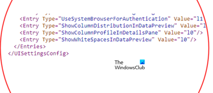

2] Modify the Power BI Settings file to add the default browser
If you don’t see an option to set the default browser for the Authentication browser, follow the steps mentioned below to modify the Power BI Settings file to add the same.
- Navigate to – C:\Users\[Your User Name]\AppData\Local\Microsoft\Power BI Desktop SSRS.
- Then, look for Users.zip, find, and make a copy of the file before we make any alterations.
- In the ZIP archive, look for the UserInterface folder, and inside it, look for Settings.xml.
- Add the following string before </Entries> line
<Entry Type="UseSystemBrowserForAuthentication" Value="l1"/>
- Finally, save the changes made to the file.
Power BI should now use a web browser for authentication with sources like SharePoint. Keep in mind that this change won’t appear in the software’s options menu, it can only be enabled through the settings file.
