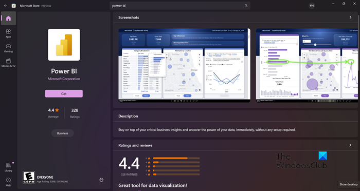

3] Uninstall 64-bit and install the 32-bit version of Power BI
You may encounter the said issue if you have installed the wrong version of Power BI. Some users also reported that the 64-bit version was working fine, but it started failing to launch and they have to install the 32-bit version. Regardless of the camp, you are in, uninstalling the 64-bit and installing the 32-bit version can resolve the issue. To do the same, follow the prescribed steps.
- Open Settings.
- Go to Apps > Apps & features or Installed apps.
- Look for “Power BI”.
> Windows 11: Click on the three vertical dots and select Uninstall.
> Windows 10: Select the app and then click on Uninstall. - Click on the Uninstall button.
- After uninstalling the app, remove the folder where you have installed Power BI (if it still exists).
Once you have removed Power BI, either go to microsoft.com\store or powerbi.microsoft.com to download the app, and finally install the 32-bit version. Hopefully, this will resolve the issue for you.
