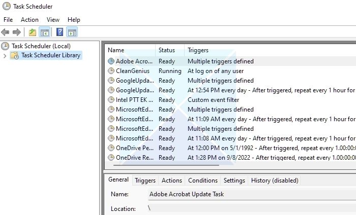

2] Check Scheduled Tasks
Do you have a scheduled task that runs in the background and can also wake up your PC? It is possible that you never created it, but maybe a backup software has scheduled for a backup with the option to wake up your PC.
- Open Run prompt using Win + R
- Type taskschd.msc and press the Enter key to open Task Scheduler.
- Check the triggers column, and look at the time for each task.
- If you notice anything that is out of place or matches up with the time you face the error, disable the task, and check for the issue.

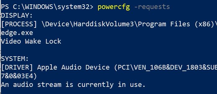

3] Run powercfg -requests command
PowerCFG is a command-line tool in Windows that can diagnose power-management issues. It works perfectly for this situation where the user is unsure why a computer woke or why the screen is not turning on, and so on.
- Right-click on the Start button, and click on Windows Terminal (Admin) or Command Prompt (Admin)
- Once it opens, execute the
powercfg -requestscommand and wait for the result. - The command will enumerate application and driver Power Requests.
- Note the program’s name, and check if you can stop the process from running in the background.
Note: Power Requests list applications that prevent the computer from automatically powering off the display or entering a low-power sleep mode.

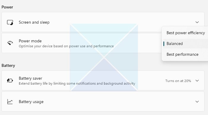

4] Check Power Plan on Laptops
Laptops have strict power plans, ensuring the battery lasts longer than usual. However, many users always keep their laptops connected to the power source. Some users also change the power plan to Ultimate Performance which keeps the PC awake.
- Open Windows Settings using Win + I
- Navigate to System > Power & battery
- Click on the dropdown next to Power mode, and switch it to balanced or best power efficiency.
These modes will ensure that the laptop display doesn’t stay on all the time and goes to sleep if not used for some time.

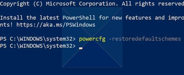

4] Reset Power Plan settings
If nothing else works and no background apps and devices are causing the problem, the last option is to reset the power plan settings. The best way to do this is using the powercfg command.
- Open Windows Terminal with admin permission
- Type and execute the command powercfg –restoredefaultschemes
- Let the process complete, and all your power plans will return to the default values that Windows offers.
It will change the laptop’s default power plan and even the configurations that Windows allows the end user to control. You may have changed some of the settings causing the problem, and the reset will fix it.
