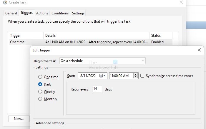

1] Randomly: Switch from Weekly to Daily Recurrence
One of the suggestions was to switch to daily recurrence from weekly for repeating tasks. So instead of setting up weekly tasks, switch to a day-based trigger. So if you want to run a task every two weeks, set it to run every 14 days.

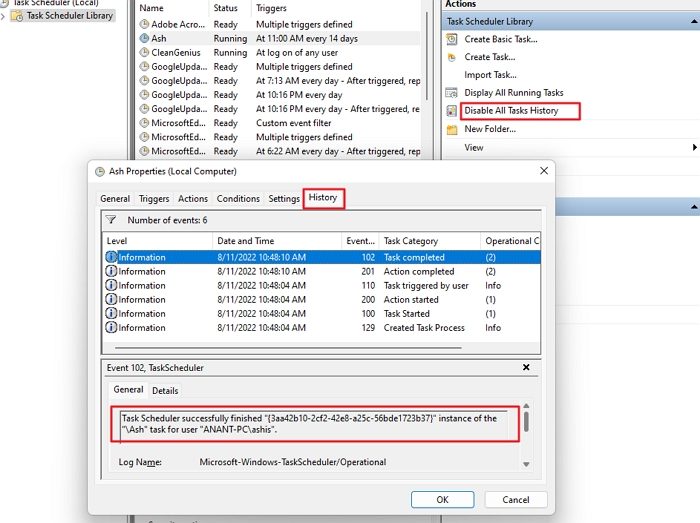

2] Multiple Times: Check if another program is triggering the task
System accounts can invoke user-created tasks as they have a higher privilege over user accounts. You need to check in the history section of the task if any of the other tasks are executing the command. While the chances are slim, it is still a possibility you should not ignore.
If you notice that the history tab is disabled, you need to go back to Task Scheduler main screen and look for Enable All Tasks history in the right column.
Once you figure it out, you can check the permission setting of the task and remove the program from the list that is not supposed to run it.

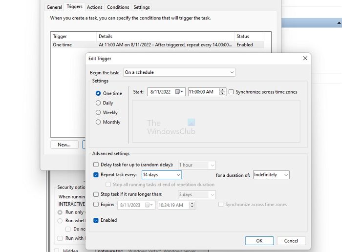

4] Add Multiple Trigger to run every fixed number of days
If switching to a daily or fixed number of days doesn’t work, the alternate method is to define multiple triggers to execute every fixed no of days and run indefinitely. If you need to run it every seven days, you can change it accordingly.
In this image, I have created a task that runs one time on a set date and time. Instead of setting daily or weekly, I created a trigger that runs every 14-days but with no expiration time. Instead of setting a daily or weekly task, use one time with the weekly trigger to keep things simple. You can also add multiple triggers if need be. This post will help you if the Task Scheduler triggers are not working.
