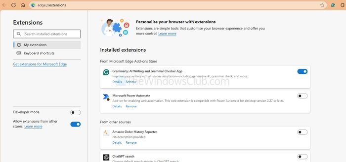

1] Disable browser extensions
Sometimes, certain browser extensions like download managers, ad blockers, Ublock Origin, or other security tools may not allow you to download files. So if you are using such extensions, consider disabling them temporarily. Then, try downloading your files and see if that resolves the issue.
You can also consider using an alternative browser that doesn’t have any extensions or add-ons installed. For instance, if you are using Google Chrome, you can switch to Edge.

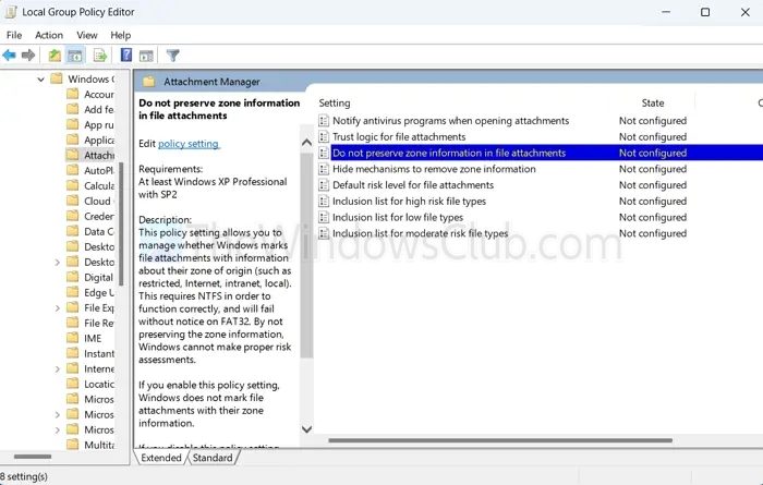

3] Modify group policy settings
If you’re an IT admin or have local admin rights, you can adjust policies that block downloads. For this, do the following:
- Press Windows key + R to open Run.
- Type gpedit.msc and press Enter.
- Navigate to the following path: User Configuration > Administrative Templates > Windows Components > Attachment Manager.
- Over here, find and double-click on Do not preserve zone information in file attachments.
- Set it to Enabled.
