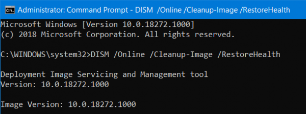

3] Run DISM Command
When you run DISM (Deployment Imaging and Servicing Management) tool, it will repair Windows System Image and Windows Component Store. All of the system inconsistencies and corruptions should be fixed. You can either use Powershell or the command prompt to execute this command.
