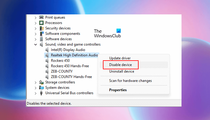

2] Disable and re-enable Realtek High Definition Audio driver
The Realtek High Definition Audio driver helps the Windows operating system to communicate with the audio devices and sound cards. The problem that you are experiencing may be occurring due to an issue with the Realtek High Definition Audio driver. Disable and re-enable this driver and see if it helps.
Follow the steps provided below:
- Open the Device Manager.
- Expand the Sound, video and game controllers node.
- Right-click on the Realtek High Definition Audio driver and select Disable device.
- Wait for a few minutes, then right-click on the driver and select Enable device.

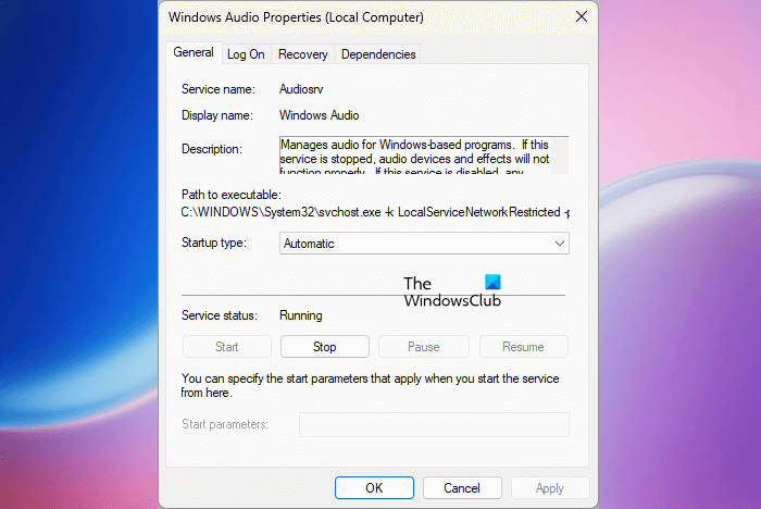

4] Check the status of the Windows Audio Service
Windows Audio Service manages audio on WIndows computers. If this service is stopped, audio devices and sound effects will not function properly. If the issue still persists, we suggest you check the status of this service. Follow the steps written below:
- Open Windows Services Manager.
- Locate Windows Audio service.
- If it is stopped, right-click on it and select Start.
- Now, right-click on it and select Properties.
- Under the General tab, select Automatic in the Startup type drop-down.
