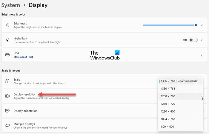

4] Change your display resolution
In case your computer’s display resolution is set to a higher resolution than the maximum resolution your MSI monitor can handle, you will experience this issue. Hence, you need to adjust your display resolution according to the specification of your MSI monitor.
To start with, check the model number of your monitor. It is written on the back of your monitor. After that, get the user manual of your monitor from MSI’s official support website. Now, check the maximum resolution that is supported by your MSI monitor.
Next, connect your PC to a different working monitor and open the Settings app using Win+I. Then, move to System > Display and set the Display resolution according to the maximum resolution your MSI monitor can handle. Finally, press the Keep changes option.
You can now reconnect your MSI monitor and see if it turns on and works correctly.
