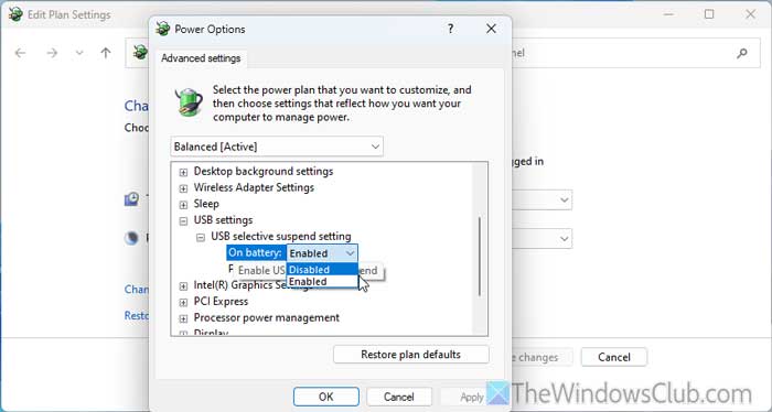

4] Disable USB selective suspend
USB selective suspend lets you disable specific USB ports when they have not been used for some time. However, the same thing can cause the issue above on your computer. That is why you are suggested to follow these steps to disable USB selective suspend:
- Search for power option.
- Click on the individual search result.
- Click the Change advanced power settings.
- Expand USB settings > USB selective suspend setting.
- Click on Enabled of On battery and choose Disabled.
- Do the same with Plugged in.
- Click on OK.

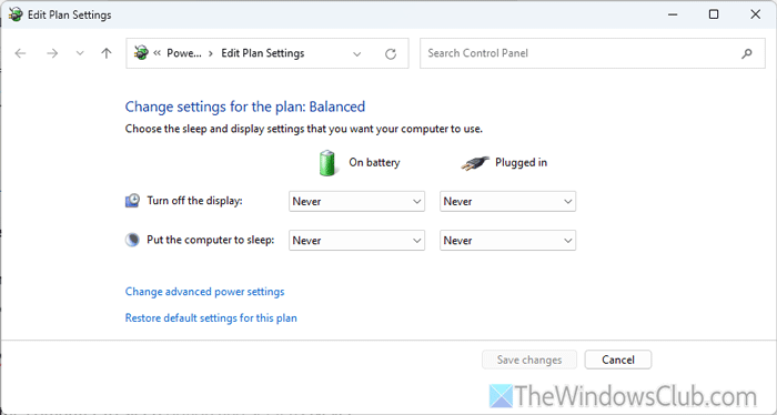

5] Check Power settings
Windows 11/10 comes with some power settings that you can use to turn on the display or put your display to sleep after a specific time. We would suggest you check those settings using these steps:
- Search for power option and click on the search result.
- Find the turn off the display option and set it as Never.
- Find the Put the computer to sleep option and set it as Never.
- Click the Save changes.

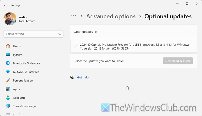

6] Update or reinstall the graphics driver
To update the graphics driver, follow these steps:
- Go to Windows Update > Advanced options > Optional updates > Other updates.
- Find the graphics driver update and tick the checkbox.
- Click on the Download & install button.
However, if you still have the same problem after updating the driver, you must reinstall it. To uninstall the driver, you can use the Device Manager. Open the Device Manager and expand the Display adapters.
Next, right-click on the graphics driver/device and select the Uninstall device option. Then, confirm the uninstallation.
After uninstallation, download the driver from your graphics card manufacturer’s official website and install it.
