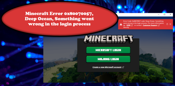

Minecraft is one of the most popular games in the world. However, as per the reports from a lot of users, there are a lot of error codes and messages that Minecraft gamers encounter. As of late, there is a new error haunting Minecraft users. According to gamers, Error Code: 0x80070057 code: Deep Ocean, Something went wrong in the login process does not them to log in to the launcher. In this post, we are going to talk about this issue and see what you can do to resolve the issue.
What is Minecraft error code 0x80070057?
Minecraft error code 0x80070057 stops the user from logging in to the Minecraft Launcher. This might seem like an Internet issue, and you can run the Internet Speed tester to know the bandwidth, however, there is a high probability that the Internet won’t be an issue. Mostly, it’s the absence of the Xbox app, corrupted files, or misconfiguration is the culprit of this issue. In this post, we have talked about reasons and methods to resolve this Minecraft error, so, go to the troubleshooting guide to find them out.
Minecraft Error 0x80070057, Deep Ocean, Something went wrong in the login process
If you encounter Minecraft Error 0x80070057, Deep Ocean, Something went wrong in the login process, follow the solutions prescribed below to resolve the issue.
