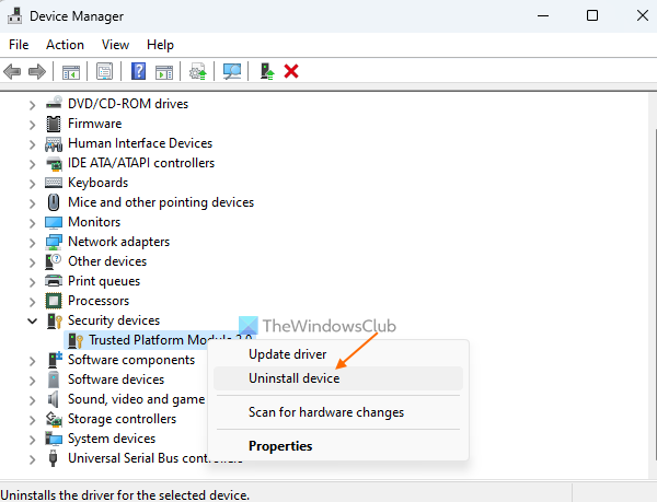

3] Uninstall the TPM driver
If the TPM driver is corrupted which is further causing this authentication problem with Outlook for the Trusted Platform Module device installed on your Windows 11/10 system, then you should uninstall the TPM driver from your Windows 11/10 system. The Windows will take care of and automatically re-install the TPM driver after the system reboot. The steps are:
- Open the Device Manager
- Scroll down and expand the Security devices section
- Right-click on the Trusted Platform Module 2.0 (or TMP 1.2)
- Select the Uninstall device option
- Press the Uninstall button in the box that pops up.
Reboot your system and Windows will install the device again. Now launch Outlook and sign in to authenticate. You shouldn’t face the problem anymore.
