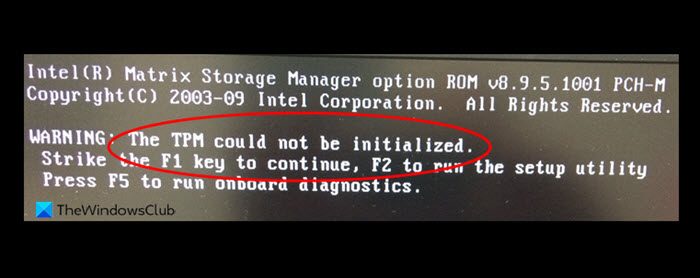

If after a BIOS update on your Windows 11 or Windows 10 computer, and you boot your system but after the BIOS splash screen you receive the error message The TPM could not be initialized which prevents you from either continuing to boot the OS or getting to setup utility, then this post is intended to help you with the most suitable solutions to resolve this issue on your Dell computer.
When you encounter this issue, you’ll receive a similar full error message along the following lines;
WARNING: The TPM could not be initialized.
Strike the F1 key to continue, F2 to run the setup utility
Press F5 to run onboard diagnostics.

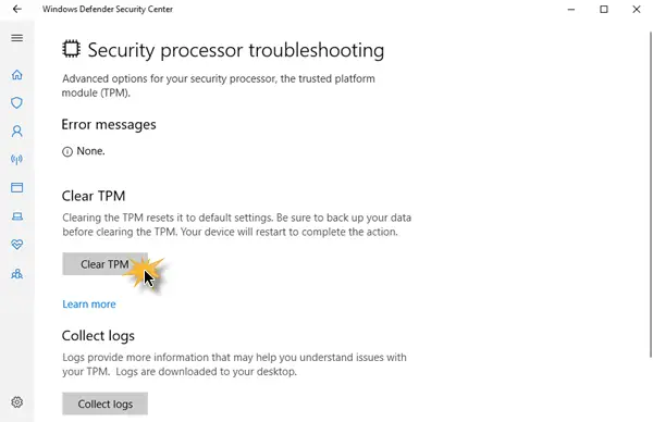

3] Update and Clear TPM
To apply this solution, you’ll have to see if you can boot into Safe Mode and then Update and Clear TPM security processor firmware.
The TPM update usually includes a patch for a security vulnerability that can affect the operating system. The update, which you will need to download and install on your device, will address any vulnerability. Clearing your TPM will reset your security processor to its default settings.

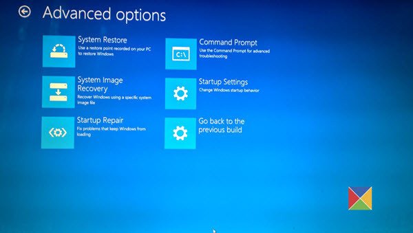

5] Perform System Restore
A viable solution to the issue in hand is to perform System Restore (any changes like application installs, user preferences, and anything else made after the restore point will be lost) – but this isn’t the usual, since your PC is unable to boot successfully to the desktop. So, in this case, to resolve the issue, you need to follow the instructions in the guide on how to perform System Restore when Windows won’t boot to desktop.
