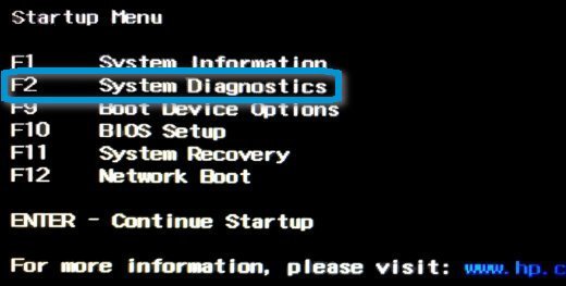

If the computer has the UEFI diagnostic tool installed on the computer, it can be launched using the F2 key. However, if the tool is not installed, you can create a USB. Lets first take a look at how you can use it when it is available on the computer.
Completely power down the computer ( hold the power button for at least five seconds to turn off the computer), and then turn it on. Immediately press the F2 key repeatedly until the UEFI menu opens.UEFI menu will give a couple of diagnostic tools, select the one you want, and follow the on-screen instructions.

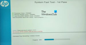

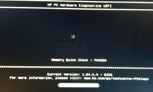

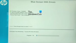

In both memory and hard disk test, the tool will run the Fast Test to identify hardware issues quickly. If there is no error detected, but the computer has hardware problems, then it will run the Extensive Test. The later can take hours to complete the test.
UEFI Fast and Extensive test

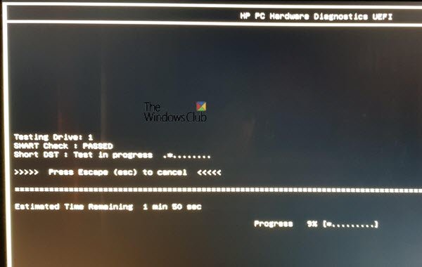

The screen displays the progress bar on a Command Prompt screen along with the estimated time left to complete the test. You can always press ESC to cancel the test, but do so only when you have no other choice.

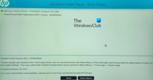

If the tool doesn’t find any error, then you should see “Passed” message, else it will kick start the extensive test.

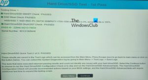

The process is the same for Hard Disk check. In our case, while the Smart Check passed, the Short DTS check failed.
It then displayed Failure ID, Product ID, and drive number related to it.
If you receive the same, you can go to the HP customer support website and enter the code, product ID and select your country to resolve the problem further.

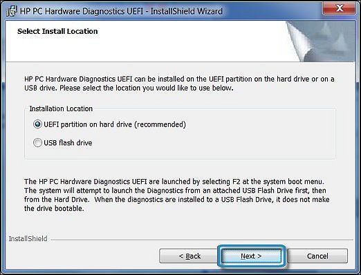

- Go to the HP Hardware Diagnostics website and download HP Diagnostics UEFI.
- Locate the folder and run the EXE file.
- Follow the installation wizard, accept the terms of the license agreement, and click Next.
- Finally, you will have to select between the installation location for the Hardware Diagnostics program, then click Next
- To download onto the computer to test, choose UEFI Partition on Hard Drive
- To download to a USB drive, select USB Flash Drive
- Click Install, and then click Yes to create the HP_TOOLS partition
- Wait while the software installs. Click Finish to close the wizard

Insert the USB device, turn on the computer, and press the Esc key repeatedly until the Startup menu displays.
Then press F2 to select System Diagnostics and the preferred language from the list.

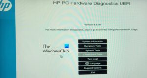

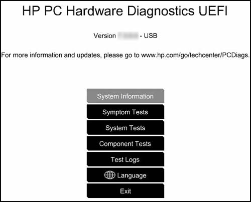

It will launch the PP PC Hardware Diagnostics home page opens, showing the version number and USB
You can now choose to run

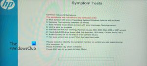

- Symptom tests
- System tests
- Component tests
- You also get access to Test logs, change language, or exit.

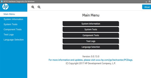

HP PC Hardware Diagnostics for Windows
If you can access your computer but have a hardware failure for audio, video, and other input devices, you can install the Windows version. They also have an app in the Microsoft Store. Similar to the UEFI tool, it offers Symptom, system, and component tests.
HP offers some incredible tools to help consumers troubleshoot their computer for any hardware issue. You will need a bit of technical knowledge to run it, and if you find it tough, you can also use HP Support Assistant, which offers one-click fixes, guided troubleshooting, and diagnostics.
