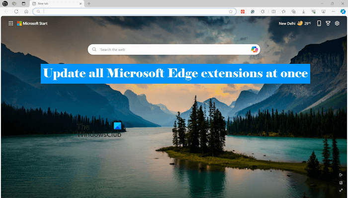

If you want to update all Microsoft Edge extensions installed on your computer at once, you can follow this step-by-step guide. You can update all the installed extensions at once in the Microsoft Edge browser. Although this browser doesn’t show an option directly, you can enable a specific functionality to make the option visible.
Microsoft Edge Chromium browser allows users to download extensions even from outside the Windows Store. The browser syncs and updates the extensions automatically. Earlier to update the extensions from the Chrome Store, you had to remove the extension and download the latest version from the Store. it. You can follow this guide to find and install updates for ALL browser extensions.
