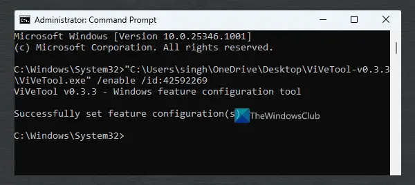

4] Enable the End task option for opened apps in Taskbar using ViVeTool
This experimental feature is currently hidden, so you need to use ViVeTool to enable or activate it. It is a very popular command-line tool to turn on hidden features of Windows 11/10 available in preview builds. Here are the steps:
- Download the latest version ZIP file (3.3) of ViVeTool from github.com
- Extract that file into a folder and open that folder
- Right-click on the ViVeTool.exe application and select the Copy as path option
- Type cmd in the Search box of Windows 11 and select Run as administrator option
- When the elevated Command Prompt window is opened, paste the path of the ViVeTool.exe application there. Continue your command by adding the enable parameter and feature ID for the End task option. The entire command is:
ViVeTool.exe /enable /id:42592269
Finally, restart your Windows 11 PC.
