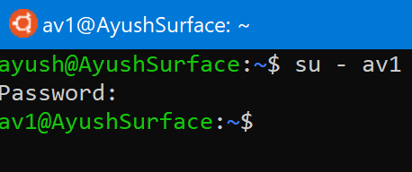

2] Switch user in WSL
When you open a WSL distro, the command line automatically logs you into the default user we talked about. But if you want to switch users to another user account, it is fairly simple, too.
Open the distro’s root location. Type in one of the following commands to switch to a particular user:
su - <USERNAME> su -l <USERNAME> su --login <USERNAME>
You will have to replace <USERNAME> with the name of the user account inside the distro that you want to log into.
