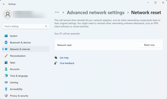

5] Reset your Network adapter
If the above fixes don’t work, you can reset your network adapter device to fix the issue. To do so, you can use Windows Settings. Here’s how:
- First, open the Settings app using Win+I.
- Now, move to the Network & internet > Advanced network settings section.
- Next, select the Network reset option and click on the Reset now button.
- When done, restart your computer and see if the problem is resolved.
