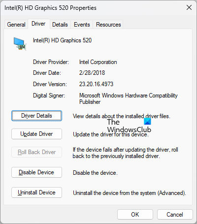

2] Update your graphics card driver
An outdated graphics card driver can cause several issues. Therefore, it is always suggested to keep your GPU driver up to date. Update your graphics card driver. To do so, you have to visit the manufacturer’s official website.
In some cases, a driver update can cause problems. In this case, you can roll back your graphics card driver to install its previous version.

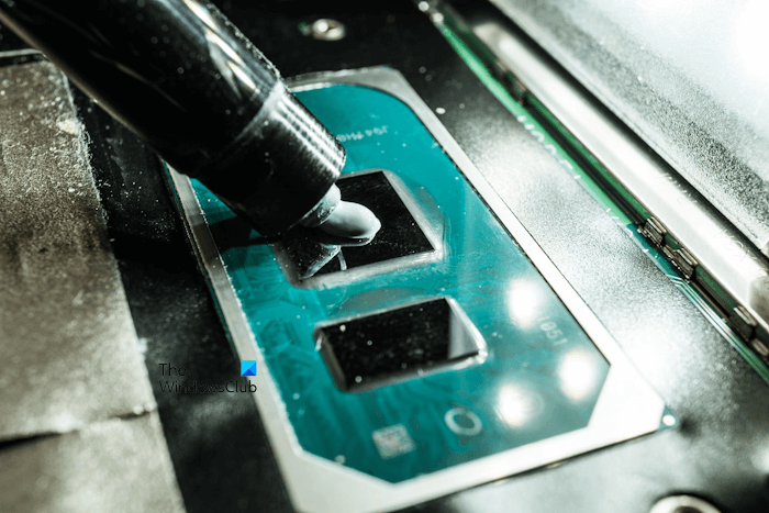

8] Replace the thermal paste
Thermal paste is applied to the electronic components to control their temperature. If the thermal paste gets dry, it will not work as expected and your GPU temperature will go high. You should replace the thermal paste of your GPU if it is dried or worn out. Take professional assistance if you do not know how to do it.
