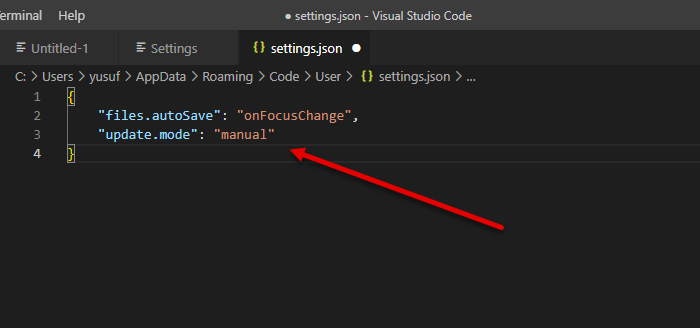

2] Stop Auto Update .JSON File
If you want to disable Auto Update using the .JSON file, then this method is for you. Settings.JSON file contains all the adjustments that you made in VS Code. Follow the given steps to stop auto-update using .JSON file.
- Open Visual Studio Code.
- Click the cog button to go to settings.
- Then, click on the file button to open the Settings.json file.
- Look for update.mode and replace it with “update.mode”: “manual”.
- Hit Ctrl + S to save the file.
Auto-updating will be disabled. However, you will still get the update notifications.
If you want to change the update mode anytime further, just use any of the following modes.
- update.mode: none =>To stop getting update notifications
- update.mode:default =>To go back to the default settings
- update.mode:start =>To start auto-update
- update.mode:manual =>To stop auto-update

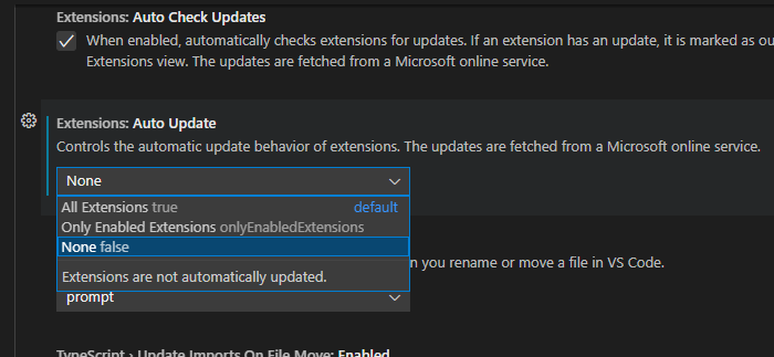

Turn off Extension Auto Update using VS Code Settings
Follow the prescribed steps to do the same.
- Search “Update” in the search box.
- Look for Extension: Auto Update.
- From the drop-down menu, select None.
Now, your extensions won’t be automatically updated.

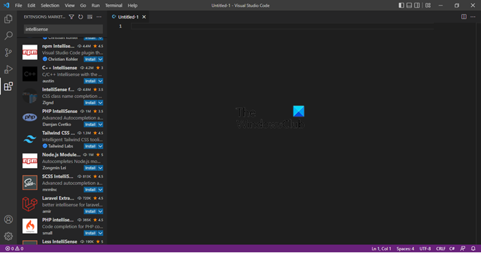

How do you turn on auto complete in VS Code?
Auto Complete can be enabled using IntelliSense in VS Code. It is a general term for various features such as code completion, parameter info, quick info, and member lists. IntelliSense features are sometimes called by other names such as “code completion”, “content assist”, and “code hinting.”
Every language has its own IntelliSense. So, if you want to download the feature, you need to just install the extension. Click on the extension’s icon from the right panel or just hit Ctrl + Shift + X, search “IntelliSense” and download the one from the list.
Read: IntelliSense not working in VS Code
