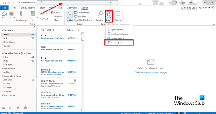

In Microsoft Outlook, there are two ways that users can disable the top search results in Outlook.
- Click inside the search box, and the Search tab will open.
- Click the Search tools button and select Search Options from the context menu.
- An Outlook options dialog box will open on the Search tab.
- Uncheck the checkbox for “Show the most relevant search results on top.”
- Then click OK.
