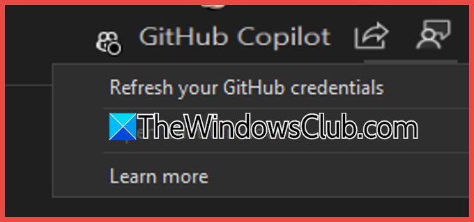

3] Refresh Copilot Credentials
If GitHub Copilot is not functioning in Visual Studio, a common problem might be expired credentials. Authentication tokens can occasionally timeout, which prevents Copilot from working effectively. To fix this, you should refresh your credentials and reauthenticate your GitHub account. You can follow the steps mentioned below to do the same.
- Launch Visual Studio.
- Now, click on the Copilot badge from the upper-right corner of the IDE.
- Now, click on Refresh your credentials to reauthenticate your GitHub account.
- Now, follow the on-screen instructions to sign in again.
