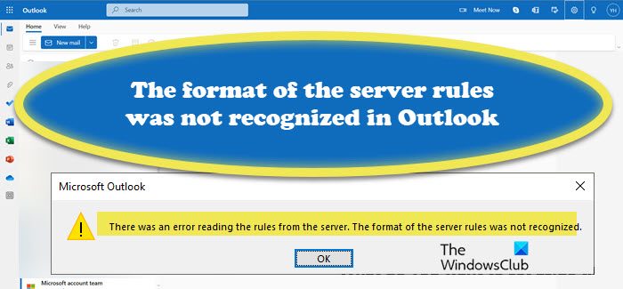

Some Outlook users have reported that when they open their mailbox from the application, they get an error message The format of the server rules was not recognized. As per the error message, Outlook fails to recognize the format of the server rules. This issue is caused by problematic rules that must be removed from the service.
There was an error reading the rules from the server. The format of the server rules was not recognized.
Fix The format of the server rules was not recognized in Outlook
The error is linked with the rule engine, therefore any issue regarding it such as
inconsistency may give rise to the error. One can remedy the situation by reloading
the rules as well as removing the rules that may cause it. Glitches in the
enforced rules or corrupted files may also be the ones causing this situation so
run the ScanPST.exe tool and reset Outlook.SRS files to get rid of this situation.

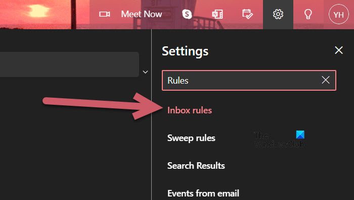

3] Delete the latest rule from Outlook.com
If the error started plaguing the device after locally adding new rules to Outlook then
make sure to reset the rules not only at the rule engine but also at a server level,
otherwise, this issue will continue to persist. In this case, we have to log in with your mailbox account into Outlook.com and delete the newly created rule.
Let’s learn how to do it:
- Launch a browser of your choice and visit outlook.office.com.
- Once Outlook opens on your computer, use the credentials you normally use to log in.
- On the top-right corner of the screen, click on the gear icon from the dashboard.
- On the Settings menu’s associated search field, type “rules” and then click on Inbox rules.
- Here we will see all your current inbox rules. Find the rule that you last added before you started to experience the error and then remove it.
