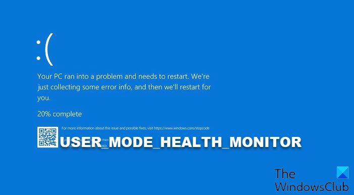

USER_MODE_HEALTH_MONITOR error in Windows 11/10 system is triggered due to incompatible hardware devices or corrupted image files. Users can quickly resolve the issue by performing a system restore using the available System Restore Points.
Also, if your system suffers from driver issues or missing system resources, you may encounter the USER_MODE_HEALTH_MONITOR error. This stop code is a Blue Screen of Death error that is triggered on a system with low storage.
The USER_MODE_HEALTH_MONITOR bug check has a value of 0x0000009E.
This bug check indicates that one or more critical user-mode components failed to satisfy a health check.
Since this error can occur due to several reasons, there is no go-to fix that you can apply to resolve the issue. SO to make it easy for users, we have outlined some troubleshooting steps to help you resolve the error in Windows computers.

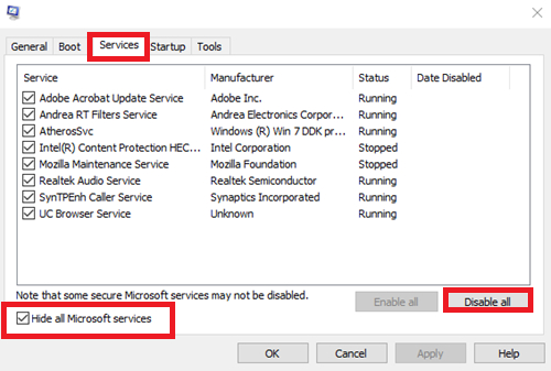

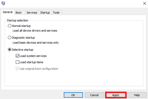

4] Troubleshoot in Clean Boot State
To enter Clean Boot State, type MSConfig in start search and hit Enter to open the System Configuration Utility. Click the General tab, and then click Selective Startup.
Click on Apply and then OK and restart the computer. This will put Windows into a Clean Boot State.
Once here, you need to troubleshoot manually to identify the offending process.
