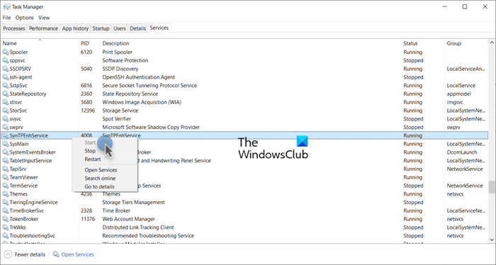

1] Make sure that SynTPEnh Service is running
First, we need to make sure that SynTPEnh Service is up and running. By default, the service will be running, but since we are experiencing an Application Error, it is possible that the service is stopped. To probe further, follow the steps given below.
- Open Services by searching it out of the Start Menu.
- Look for SynTPEnh service.
- If the Status is Running, move to the next solution, but if it is stopped, right-click on it and select Start.
Now, close Services and reboot your computer. Hopefully, now you won’t face an Application Error.
You can also Stop, Restart or Start Services using the Task Manager. Open the Services tab, right-click on the Service and you will see the available options.

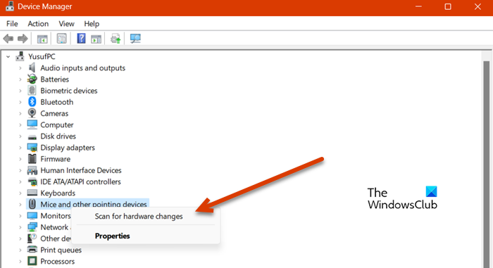

3] Reinstall Synaptics Driver
If updating drivers is unsuccessful, it is very possible that your driver is corrupted. The driver can become corrupted due to improper installation of driver updates. To resolve the issue, we can reinstall the driver. Follow the steps given below to do so.
- Launch Device Manager.
- Expand the Mouse and other pointing devices option.
- Right-click Synaptics Pointing Device and click on Uninstall device.
- Click on Uninstall to confirm your action.
- Now, restart your computer; hopefully, the driver will be reinstalled.
- If the driver is not installed, right-click on the Mouse and other pointing devices and click on Scan for hardware changes. This will scan for a missing driver and install the correct driver.
