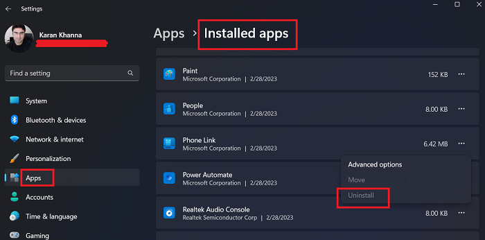

You can use Windows Settings to uninstall the Phone Link application. The procedure is as follows:
- Right-click on the Start button and select Settings from the menu.
- In the Settings menu, go to Apps > Installed Apps.
- Scroll down to the Phone Link app and click on the three dots associated with it.
- Select Uninstall.

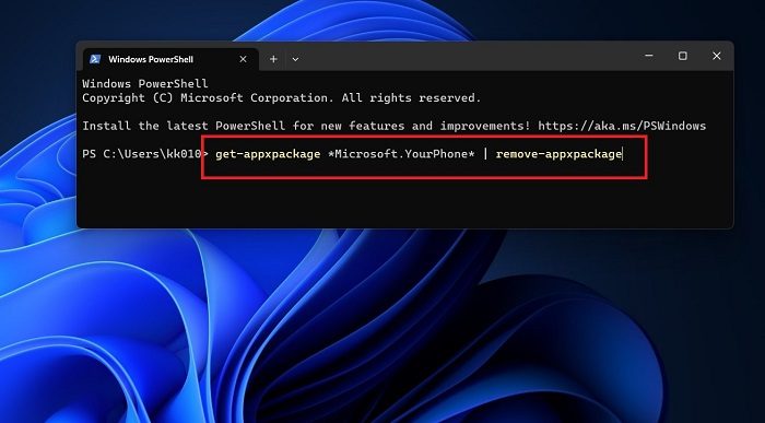

You can also uninstall it using a Windows PowerShell command. The procedure is as follows:
- Search for Windows PowerShell in the Windows Search bar.
- Click on Run as administrator in the right pane to open the elevated PowerShell window.
- In the elevated PowerShell window, type (or copy-paste) the following command and hit Enter to execute it.
get-appxpackage *Microsoft.YourPhone* | remove-appxpackage
- Reboot your system and check if it helps.
