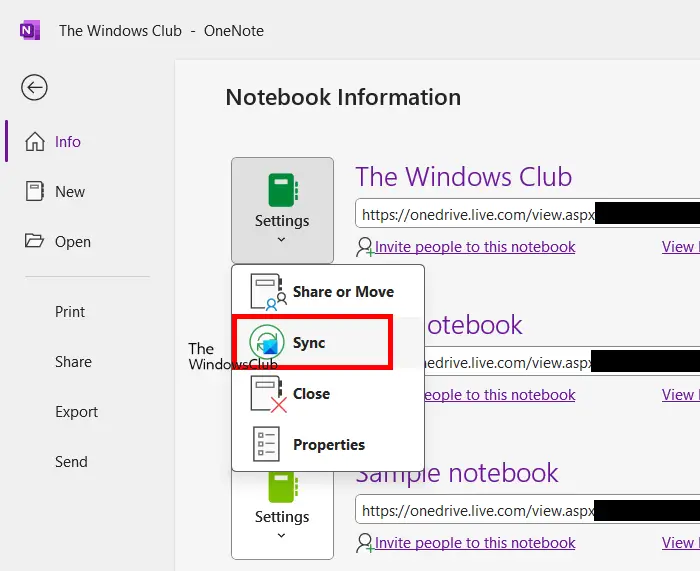

2] Manually sync your notebook(s)
If the above fix does not work, you can also try to sync your notebooks manually. The following steps will guide you on this:
- Open OneNote.
- Click on the File menu.
- Select Info from the left side. You will see the list of all your notebooks.
- Click Settings and then click Sync for the problematic notebook.
Now, check if the issue persists.

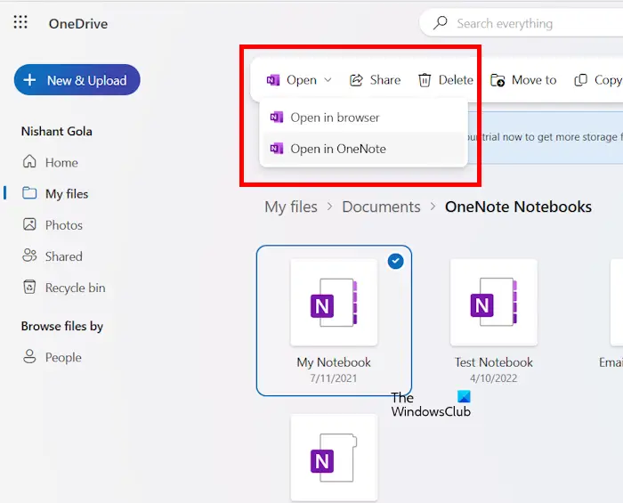

5] Try to open the notebook through your browser
Open your web browser and open OneNote for the Web. Sign in to OneNote for the Web in your web browser with the same Microsoft account. After that, rename your problematic notebook online and then move it to a different folder in OneDrive. Now, open that folder in OneDrive in your web browser and locate that OneNote notebook. Select that notebook and click Open > Open in OneNote.
If you get a prompt in your web browser, accept it. The notebook will then open in OneNote. This time, it should start syncing without the error.

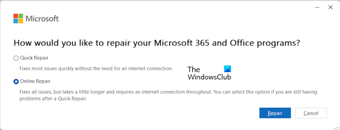

6] Repair OneNote
If the error persists, repairing OneNote can help. Follow the instructions provided below to repair OneNote:
- Close OneNote (if it is open).
- Open Windows Settings.
- Go to Apps > Installed apps or Apps > Apps & features (whichever is applicable).
- Search for Microsoft OneNote.
- Select it and click Modify. In Windows 11, the Modify option will appear after clicking on the three dots.
- Click Yes in the UAC Prompt.
- Select Online Repair and click Repair.
