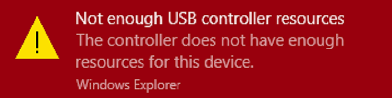

USB is now being used in all devices. USB A is leading with most devices based on it. Peripherals like Pen Drives, External Hard disks, and more use a USB port. USB C is coming up to be the next big standard in the computing world due to its high transfer speeds, wider compatibility, and support for external Graphics Processing Units. However, USB 3.0 ports have been reported to be causing the following error to appear on Windows 11/10 whenever a USB device is plugged in:
Not enough USB controller resources, The controller does not have enough resources for this device.
